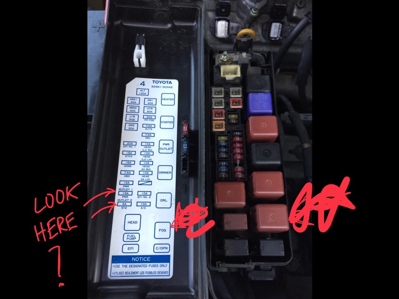

    New wrinkle, everything in the fuse block EXCEPT the Pwr Outlet fuse has good power, it has nothing. Anybody have any ideas that don't include me tearing the dash apart looking for a needle in a haystack of like-colored wires? Cause if not, I'm going to buy an add-a-fuse and wire them to the seat heater 15A fuse since I don't have a seat heater instead of taking on that wild goose chase.

    Professional Hand Model
    #14878
    14,987
    Fred
    Hand Protectors
    hammeron likes this.

  9. Jun 17, 2019 at 4:30 PM
    #14878
    14,987
    Fred
    Hand Protectors
    Yes (edit* no it under the hood near the battery) Another possibility is...

  10. Jun 17, 2019 at 4:37 PM
    #14878
    14,987
    Fred
    Hand Protectors
    For some reason, if you have to pull the relay let me know how you do it. I’ve not been able to pull any of mine for fear of breaking them as the tug pressure was making my spidey senses say stop.

  11. Jun 17, 2019 at 4:45 PM

    They should just pull straight out (only 4-5 prongs holding them in).

    Mine must be corroded in. Nothing is broken so I’ll leave them alone until some electrical problem. Thanks for the heads up.

    I'll check that tomorrow PHM, fuse block on mine looks quite a bit different than yours but I'm sure there's something there. New symptom presented tonight, went back out to take the truck out and now the cig lighter is also gone as well as the keyring light (I'm sure they're on the same circuit) so I've definitely got a problem with the entire circuit now. Will troubleshoot more in the morning before saying screw it and putting the whole circuit on an add-a-fuse.

    Check the 15 amp acc or cig fuse under the dash and the 10a dome under the hood.
