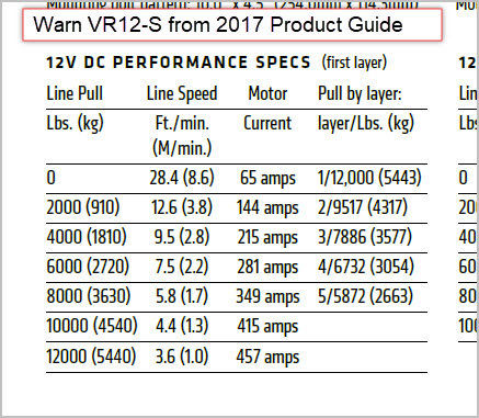

    You won’t get full capacity if your fully spooled with rope either. The more wraps you have on, the harder the motor has to work
