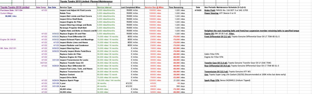

    Just purchased my first Toyota, a 2019 Toyota Tundra Limited 4x4 TRD Off Road at 95K miles. I am quickly approaching 100K and wanted to do the service myself. Being a marine engineer how has to service lots of equipment onboard, I made an excel spreadsheet of recommended services. The previous owner serviced the engine oil and filters on time but lacked on some of the other services (transmission, coolant, 4x4) and used it as a work truck, as the bed is pretty beat up. What I have read online (Forums and Care Care Nut) conflicts what the dealerships are telling me. Below are the services I am planning on having done, please let me know your thoughts and if there is anything I should add or hold off on doing. Hesitant doing the transmission and differential oil replacements might do more harm than good. I plan on having the dealership do the tire rotation and coolant replacement since they have the vacuum tool but plan on doing the other services myself. I have not worked on cars (only my motorcycle) since I live at sea/abroad 90% of the year since my job gives me a car to use when in port. The truck was used in Northern Virginia previously and the undercarriage is clean with very little rust, but now sits next to the ICW in Florida.
    100K Planned Service:
    Dealership Services:
    -Tire Rotation
    -Coolant Replacement: Toyota Super Long Life Coolant (50/50)
    Tiptop93 Services:
    -Transmission Oil Replacement: Toyota Genuine ATF WS(12.3 qt/11.6L) (I'm hesitant to do this because it is at 100K and have read to forgo the services and pray it has a long life at this point)
    -Engine Oil and Filter (0W-20, 8.5qt/8L) (P/N: 04152-YZZA4)
    -Front Differential Oil Replacement: Toyota Genuine Differential Gear Oil LT 75W-85 GL-5 (2.2 qt/2.05L)
    -Rear Differential Oil Replacement: Toyota Genuine Differential Gear Oil LT 75W-85 GL-5 (4.0 qt/3.5L)
    -Transfer Case Oil Replacement: Toyota Genuine Transfer Gear Oil LF (SAE 75W)(1.6 qt/1.5L) OR Redline Oil
    -Test Brake Fluid Water Content (FMVSS No. 116 DOT 3 or SAE J1703)
    -Inspect Cabin Air Filter (P/N: 8713950100)
    -Inspect Engine Air Filter (P/N: 178010P100)
    -General Inspection of Hoses
    -Brakes and Tires New at 95K
    Recommended Adds:
    Seafoam in fuel tank and crankcase prior to service
    Spark Plug Replacement (P/N: Denso SK20HR11) (Iridium Tipped) Gap: 0.043in (1.1mm)
    Serpentine Belt Replacement (P/N: 90916A2033) (Inspect water pump for leakage with belt off)
    Power Steering Fluid Replacement: (ATF Dexron II or III)
    PCV Replacement (P/N: 1220438030)
    Throttle Body Cleaning
    MAF Sensor Cleaning (MAF Cleaner)
    Check for drive shaft zerks
    Check for Slip Yoke Zerk
    Test battery/Top up with DI water
    Order oil drain sealing washer/crush washer
    Order transfer case drain sealing washer/plug
    Order 2x differential sealing washer/crush washer
    Any other 4x4 services that should get done (re-torquing, greasing, etc)?
    Thank you all!

    I would do everything you’ve listed.
    Replace the serpentine belt.
    I would also replace the power steering fluid.

    You can do all of this yourself, you are more than capable enough. I would do just a drain and fill on the trans and see how it feels and depending how the fluid looks, think about doing another drain and fill at your next oil change.
    Front and rear diffs are stupid easy. Hardest part is being on level ground. 75w 90 on both and get a gasket kit on Amazon. For the transfer case do oem or ravenal.
    Do the pcv also, it's 8 bucks and takes 3 minutes.
    Coolant is easy too, getting to the block drains isn't bad just turn the wheels. If you feel like being extra thorough, take off heater core plumbing and blow some air through it to drain more.
    Clean your throttle body and your MAF sensor too. You should see mileage increase if those haven't been done in a while. Make sure to use actual MAF cleaner spray.
    Power steering is really easy too, get it out, fill, turn wheels to lock a few times and check level.
    I don't think you have zerks so no need to lube driveshaft. Maybe the slip yoke...
    Lastly top off your battery cells with DI water.
    While doing belt check water pump for seepage.
    Empty brake reservoir and refill then bleed brakes, this would probably be the hardest of all the items though not bad if you have a bleeder kit.
    Spark plugs would be a good idea since your already there. Definitely use the stock plugs from Toyota.
    Before all that, maybe run a can of seafoam or equivalent through tank and crankcase.

    MadMax- Thanks for the response and the links! The diffs look super easy, I'm praying that the drain plugs come out without a fuss. I'll add those items to the list and be sure to inspect the water pump. I have a brake bleeding kit for the motorcycle, should make it a simple job but was going to wait and see what the brake fluid tester read. I heard they aren't super reliable but it at least might give me something to go off of if I check it bi annually.
    When cleaning the throttle body, are use also using the MAF Cleaner or I see CRC has a throttle body spray?
    Looks like I have some homework on youtube. PCV valve looks super simple along with the slip yoke. Cleaning the throttle body and MAF sensor is on my "watch next" list.

    Looks like a good list. They did away with the zerks on the driveshaft sometime in the 2018 model year. Mine does not have them.
    Do change the trans fluid.
