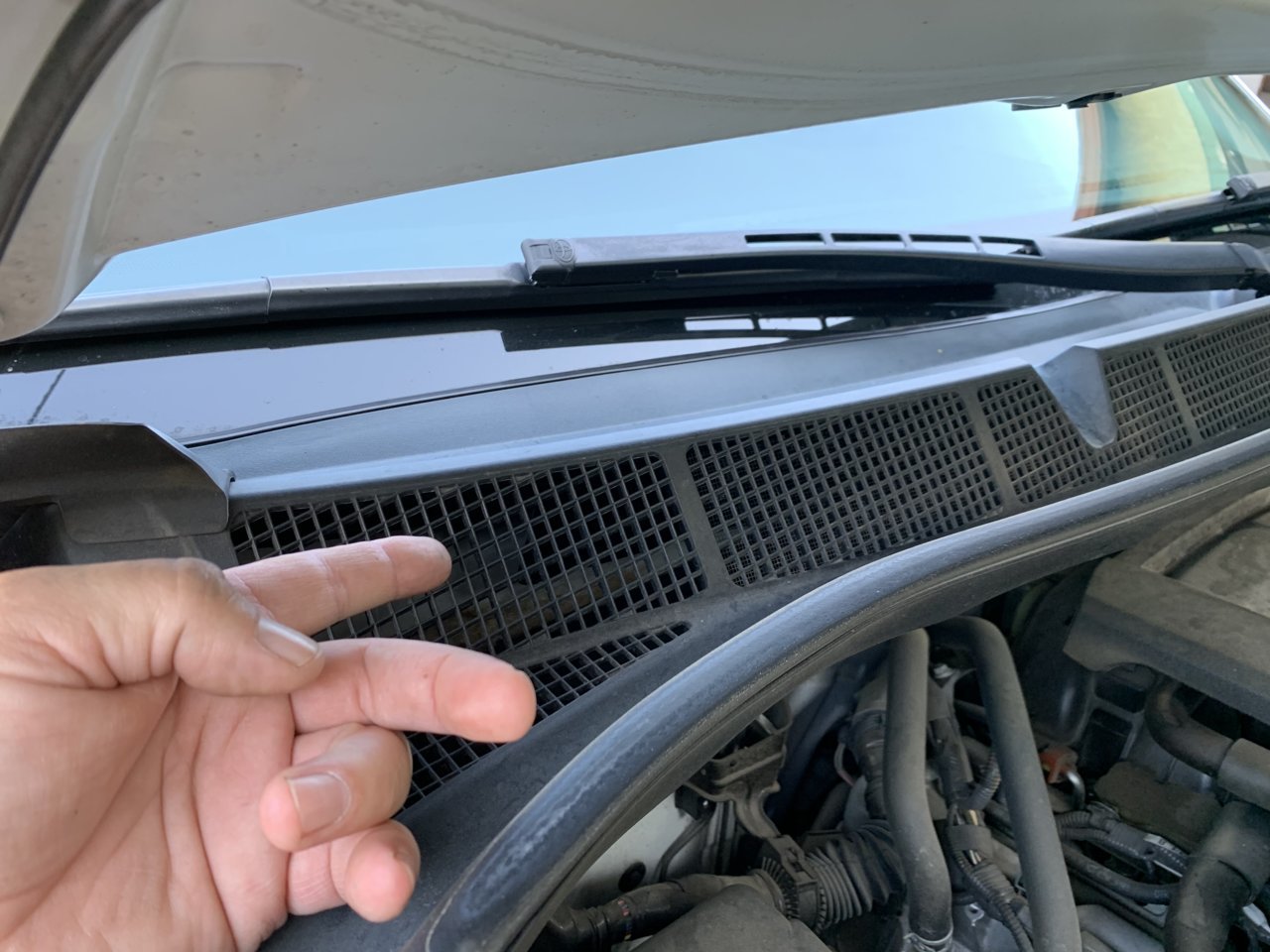

    Maybe block this area off here with some painters tape. It’s not a 100% seal because it does drain out of there before it would ever enter into the truck. You would have to remove the cowl to block it completely and access the vent behind it.

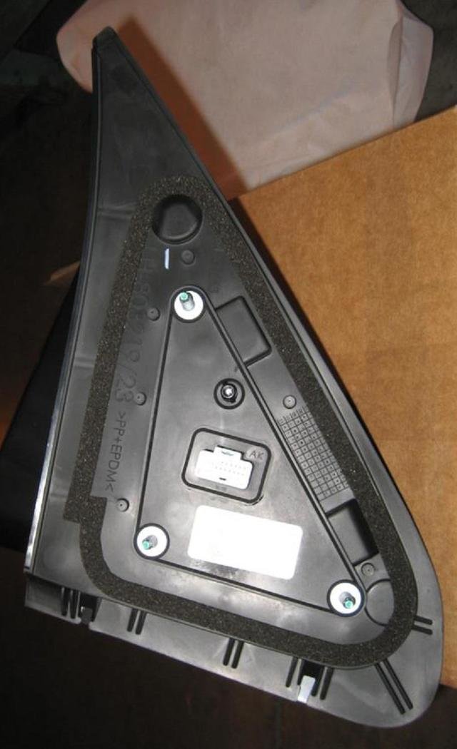

    There is one more thing that I need to investigate before I order the water deflectors... the whistle is loudest and seems to come from behind the corner cover on both doors. This cover hides the bolts and wiring associated with the outside mirrors, maybe the gasket seal on the set of pre-owned mirrors has failed ??

    I thought that there was another, more substantial rubber gasket for the mirrors, I can't seem to find it on a dealer parts list though. I'll try to look at my truck to see if it's visible without actually removing the mirror....
    Ya, I can just barely see something in there. I think that the mirror would have to come off to get a p/n though, and as sure you're aware, the door panel has to come off first. Maybe Roman can find it without breaking out the hand tools.

    The foam on the mirror is attached to a rubber gasket that is attached to the mirror base where it mounts to the door. Looks like it is still there in the picture of the mirror. I guess it's possible it could have failed, but it doesn't look bad in the pic.

  28. Nov 19, 2019 at 2:27 PM
    #28
    Rex Kramer
    Rex Kramer [OP] Vinyl Spinner
    Apr 9, 2017
    #7181
    6,606
    Georgia
    2002 4.7L RCLB 4X4 2007 5.7L RCSB 4X2
    That picture is a stock photo of a brand new mirror, I will probably remove & inspect mine tomorrow or Thursday.

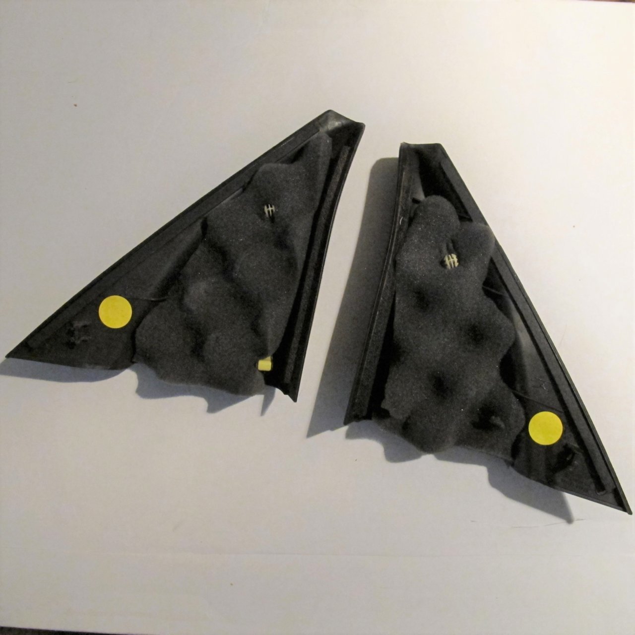

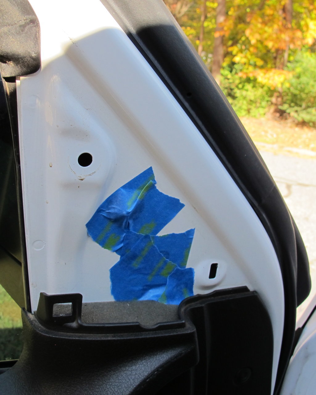

  29. Nov 20, 2019 at 10:22 AM
    #29
    Rex Kramer
    Apr 9, 2017
    #7181
    6,606
    Georgia
    I believe that I have nailed down the source of the whistle!
    My temporary solution: Painters tape over the top mirror bolt hole, another hole plus the top of the electrical power connection. I then cut some sound deadening acoustical foam and stuffed into the corner covers. A quick road trip confirms that my makeshift solution is working. I will use this solution for now, and work out a permanent solution later on.
    Tripezius, NWExplorer and Trooper2 like this.
