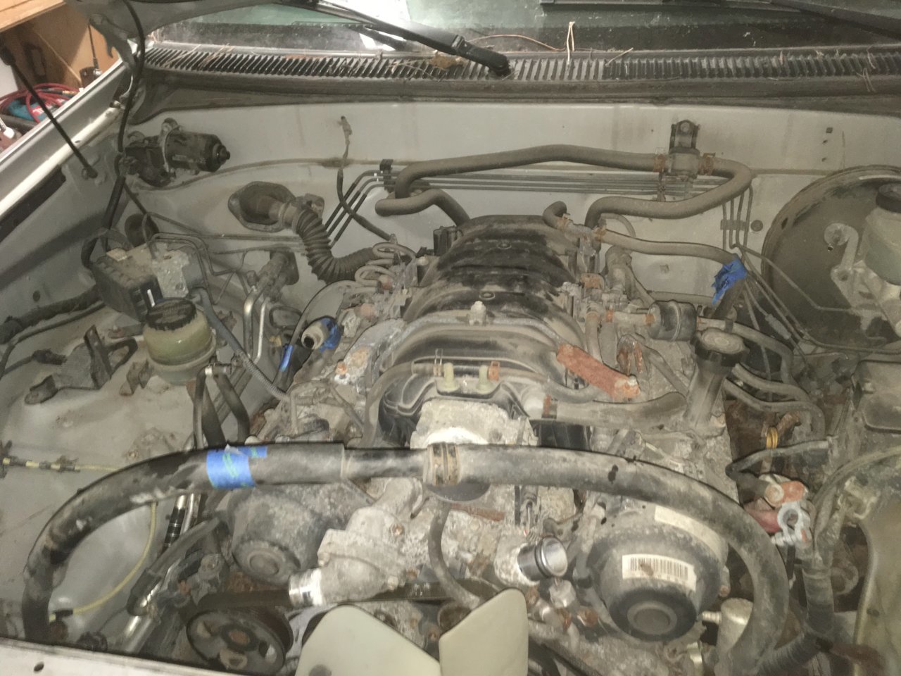

    Tonight I finished disconnecting things under the bed and started working on things in the engine bay. Drained the coolant, removed the intake, radiator, hoses, AT cooler lines, vacuum lines, and some other stuff. Managed to snap a rusty bolt head on the shift linkage, so need to do some work on that, as well as the, brake lines, parking brake, etc. Taking good notes and marking things as I go. Biggest issue currently is where to put everything in my garage.
    My plan is to get everything disconnected and leave the body sitting on there until I can get a frame sourced and start building it up. Then I will devise some contraption to lift the body and roll the new frame under. Easy enough! If anyone has or has a lead on a frame in the Michigan - Ohio - Illinois area, or has a good idea on where to source one shipped, I'd be very interested.
    Here's some pictures for the day.. probably won't make much, if any, progress this weekend as my in-laws will be in town.
    Broken shift linkage:
    Engine bay sans some stuff

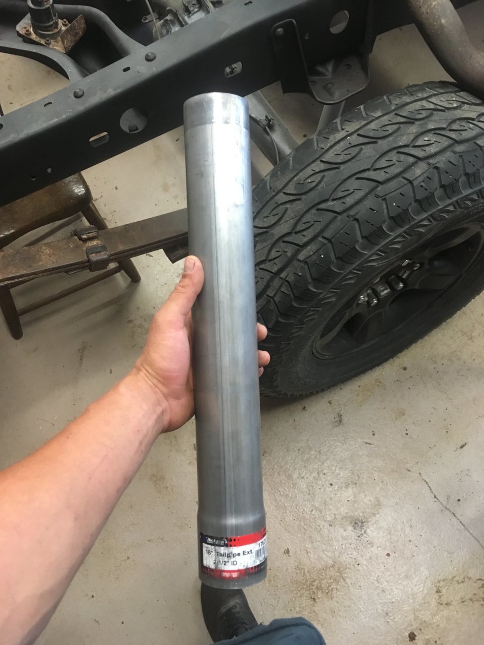

    At some point I also welded up the exhaust with a combo of some cheap tubing, the original tail pipe, and a flowmaster parts store special. I think the hangers were mostly random round stock I had laying around.
