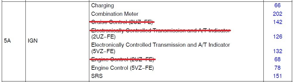

    If your able to find the EWD link shift linked to, these will be the circuits assoc with 5A IGN fuse.
    Good luck....finding a short to ground can be tedious but feel with the EWD you'll be able to check the circuits methodically.

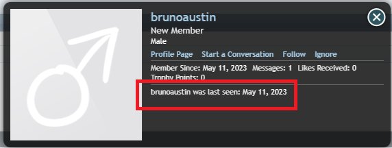

    Like so many strangers making it here from the internet with "1st interaction with the community is a problem instread of a hello", @brunoaustin hasn't logged on since he made this post. My guess is, one of the last two posts helped steer him to the solution, but we will never know what it is, because he never followed up. We see both here, a lot. I tagged him here with hopes he gets an email alert and can hop in to let us know what happened. Don't miss that link in my reply above. There's a ton of technical data at your fingertips in the first links of that thread I provided a link to.

    @BubbaW's picture above is taken (I believe) from the EWD (electrical wiring diagram) which literally gives you ever circuit attached to the IGN fuse, and you can look in that manual to see what color the wire is and trace it back.
    Like, "Combination meter" is your gauge cluster. Did you change any bulbs recently?
    Or "Charging" would be your alternator/power circuit, did you do anything with those wires recently, OR has the battery ever been corroded? Internal corrosion will cause shorts and wires to heat up, which blows fuses. These trucks are notorious for corrosion inside the cables. Try pulling and cleaning the terminals. You get the idea, I hope.
