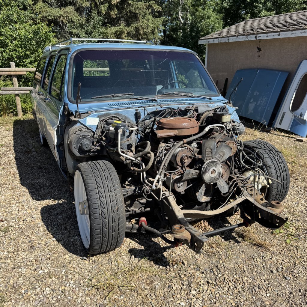

    Finished the front drop last night. This is the ride height of the front. I’m stoked.
    I’m not fully done the front yet though.
    I’m going to drill the front rotors out to swap from 7/16” to 14mm studs so they match the rear axle. These wheels are designed for 14mm studs as well. Need to put brake pads back in too. I also have a poly sway bar bushing kit coming for it.
