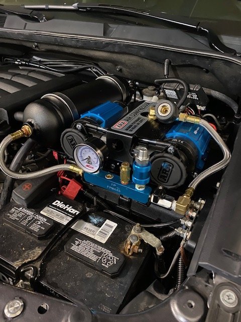

      What is that?
    • BayRunner
      @vlor , it's an on-board air system with the "wifey" system. The "wifey" system has air valves in the wheel well of all 4 wheels which allows me to deflate / inflate all 4 tires at once. The gauge will display the pressure in all 4 tires while the other items on the blue manifold is a safety pressure release valve and a manual valve for deflations.
